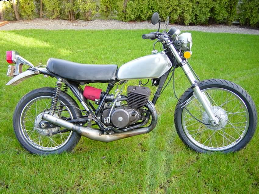

Could you share your jetting specs? I have a 32mm flat-slide on my bike right now, but it needs more.

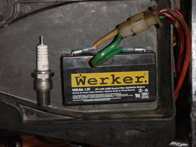

Here's a pic of my new battery. The 6volt system limits you somewhat as far as battery eliminator kits, trick lights, etc. I tried a large capacitor in place of the battery at first, but that kept blowing out the taillights. This new 6V battery is a sealed AGM (absorbed glass mat?) lead/acid type battery originally intended for emergency lighting panels & alarm systems. So far it is working great & weighs a fraction of the original.

PostPosted: Sat Feb 05, 2011 7:29 pm
Joined: Sat Feb 05, 2011 12:16 am
Does the AGM Charge while on the bike or do you ahve to recharge it with a charger? also could you run your winker off of it or do you just choose not to have them?

The battery charges off the bike like the OEM battery did. I picked up the new battery at my local http://www.batteriesplus.com
I had removed the blinkers prior to this modification & have no idea if they would function or not.

PostPosted: Sun Feb 06, 2011 3:39 pm
The stock battery was about 5mah and the one he has there says its 1.3 ah so if its really 1.3 ah and not 1.3mah it would run the blinkers just fine. I am basing all of this on what I think to be tru that is ten mili amp hours equal one amp hour. I really dont see how such a small pack could be 1.3 ah but I dont really know much about electrical. I put a battery pack on mine meant for rc car remotes and it works everything just fine.

PostPosted: Sat Feb 12, 2011 1:33 pm
JM,
Your bike looks lean, mean, and ready to go! The MT gearbox should work great for street riding, and the MT front brake is actually pretty decent.
As you may know, I've been hopping up two MR175-powered bikes for what seems like forever. One thing I've learned is that the MT125, MR175, and MT250 cylinders are virtual clones, differing mainly in dimensions, not design.
Unless you've opened up that MT intake manifold to where the rubber is paper-thin (NOT recommended, obviously), you won't get any more than 29mm or so of poor-quality flow out of any >28mm carb. I fit a 30mm in my MR175 manifold (extremely similar to the MT250's manifold) and it worked like crap despite many jet / needle / slide changes. I couldn't believe how much better it ran when I put the stock 28mm carb (identical to the MT250's) and manifold back on. Fixing the 30mm setup took a lot of work which I won't bore you with, but it can be done.
Long story short: if you want max performance, minimum down time, and plenty of online support, I would go with the CR250 (or MR250?) cylinder transplant. Your carb-mounting problems will vanish, your existing pipe will match the porting, and your bike will fly (you may be surprised at how well the 32mm carb works, especially down low). If a bolt-on top-end solution like that was available for my MR, I would have done it in a hearbeat.
If you decide to stick with the MT250 cylinder there's still plenty that can be done, but it will take a lot of work to get to maybe 75-80% of the CR250's output.
