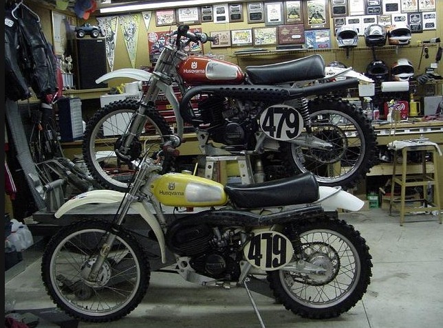

PostPosted: Mon Jan 21, 2013 11:23 am
I was Midwest regional #1 and National # 4 on it.
All I had to do was match the taper on the rotor to that of the 250 crank, then make a base plate for the stator.
Mud races here in Ohio made me toss the points. Eventually my friend, the now late Dane Leimbach, set me up with a PVL which worked well.
I spent allot of time dialing in my 2fiddy and it worked well, just not well enough as say a mag 2fiddy or a hot penton. They didnt handle near as well as a hoosk and the down pipe just plain sucked. The foot pegs would break off, the frames and aluminum tank would break......
I ran a DG radial head, GEM reed, T&M swingarm, 125 steel tank, jemco pipe and not in the pic was works rear shock.
As soon as I could I built a mag 2fiddy......
Ill BET I still have the set up somewhere in my vast inventory.
