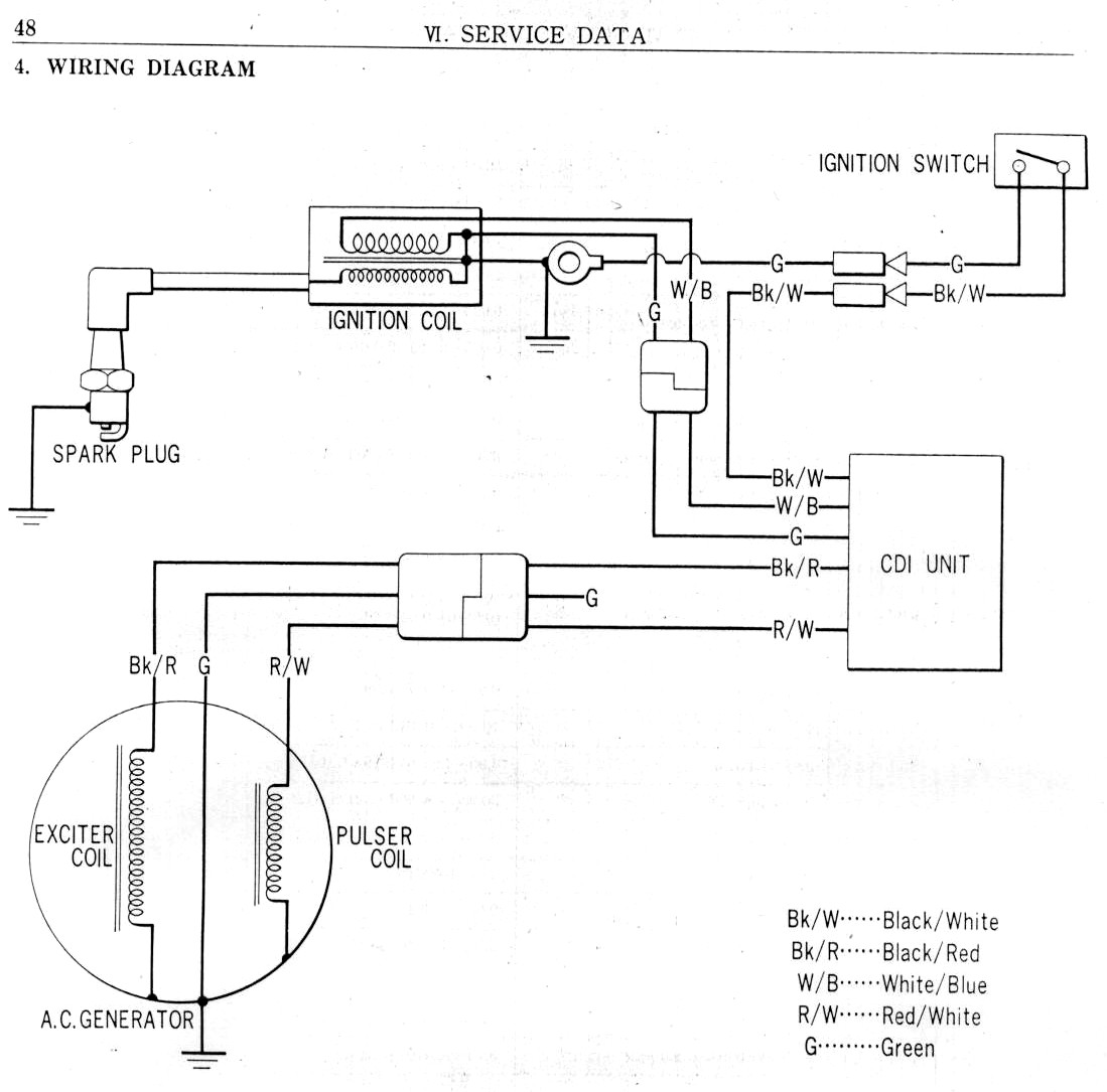

As Mentioned above, i really need this diagram, doe anyone have one please?

PostPosted: Thu May 14, 2009 6:05 am
Here it is:
PostPosted: Thu May 14, 2009 12:26 pm
Joined: Sat May 09, 2009 5:49 pm
That can't be it... ive only got 2 wires coming out of the engine, a yellow one and a black with yellow line on it...

PostPosted: Thu May 14, 2009 4:09 pm
No problem - glad to help. I'm sure Honda service manuals are wrong sometimes, and my own CR125M (bought new in '74, and identical to the diagram in all respects) must be a fluke.
PostPosted: Fri May 15, 2009 9:35 am
Thanks anyway
sounds like you have the wrong ignition in it. :(

PostPosted: Fri May 15, 2009 6:49 pm
Agreed - that's certainly a much more likely explanation than an incorrect factory diagram.
I've got three complete ignitions here (two '74's, and one '75) that are identical to the diagram I posted.
P.S. Below is a picture of a '74 CR125M stator assembly. Check out the black/red wire coming from the far end of the left coil, and the green and red/white wires coming from the right coil.

PostPosted: Fri May 15, 2009 9:05 pm
Posts: 126
I have the same diagram as Ray. That's listed in the original manuel for the CR125's.

PostPosted: Sun May 17, 2009 8:47 am
hmm strange, in the cehicle registration it says cr125, and the engine hasnt been taken apart.... i DO have mr175 engines here, so unless someone modified it without my knowledge, its wrong.

PostPosted: Wed May 20, 2009 11:23 am
Posts: 126
Is there a serial # on the engine cases? Left hand side above the ignition cover?
