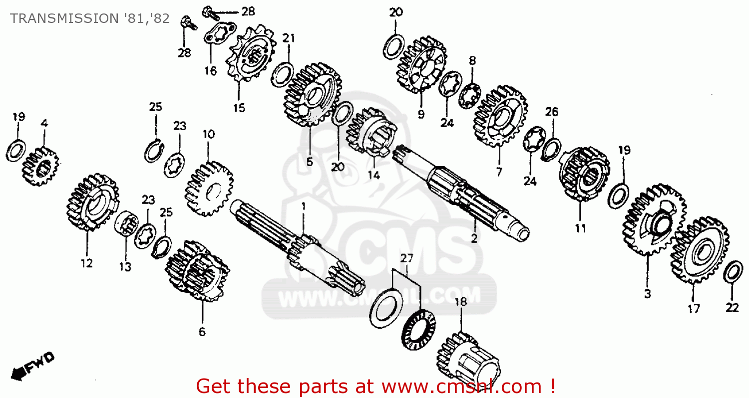

Is it a washer shown on this diagramme
http://images.cmsnl.com/img/partslists/ ... 9_ddd2.gif
Or one from this diagramme ?
http://images.cmsnl.com/img/partslists/ ... 6_450b.gif
You may find this page of some help
http://www.cmsnl.com/honda-cr125relsino ... l_q=cr125r

Thanks for the help. Its the one in this diagram http://images.cmsnl.com/img/partslists/ ... 6_450b.gif . On my bike its a oittle different as the washer I think came out from behind the idle gear and not between the rachet and the idle gear. Wichever place it came out of Its now behind the idle gear inbetween the inner case and the gear. Dont ask me where is came from as the whole thing fell apart apon opening the case up haha. But will it really mess something up if its in a slightly differnt spot?

I found my bikes kickstart diagram. It does go behind the idle gear after all.http://www.cmsnl.com/honda-cr80r-1981-u ... ml#results
After looking around on that site you posted the link to I was able to find it. Thanks, the place will really come in handy with all the diagram pages. But again if that little washer isnt on there after all what damage could it cause? Thats a bad design with the kickstart- only way to put an assembled kick shaft on is to remove the whole clutch.
