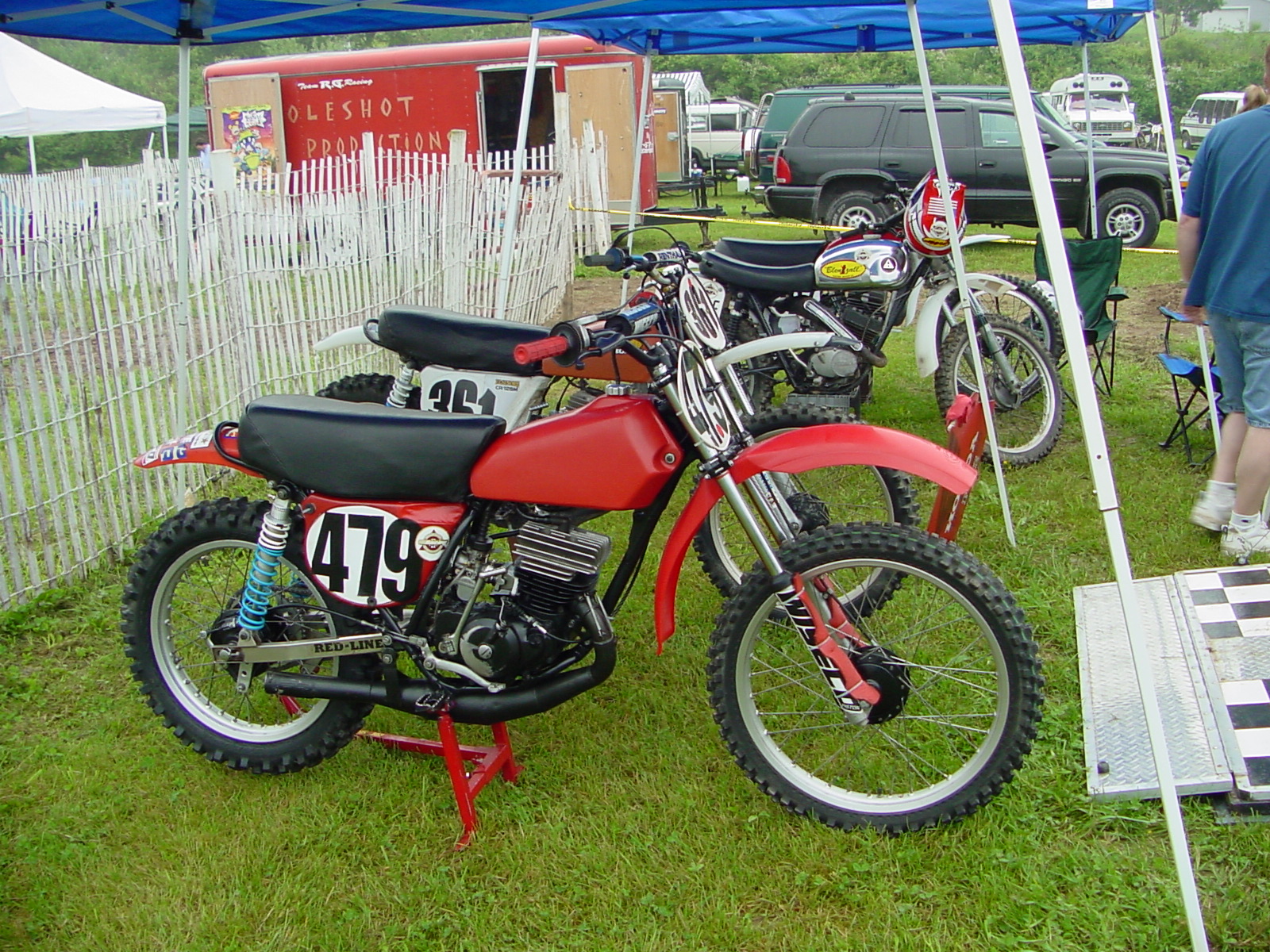

I know Im a goofball with doing crazy things to my bikes but I made an aluminum one that went straight down from the bottom shock bolt, simply because the Red-Line swingarm I ran didnt have a front brake arm mount.

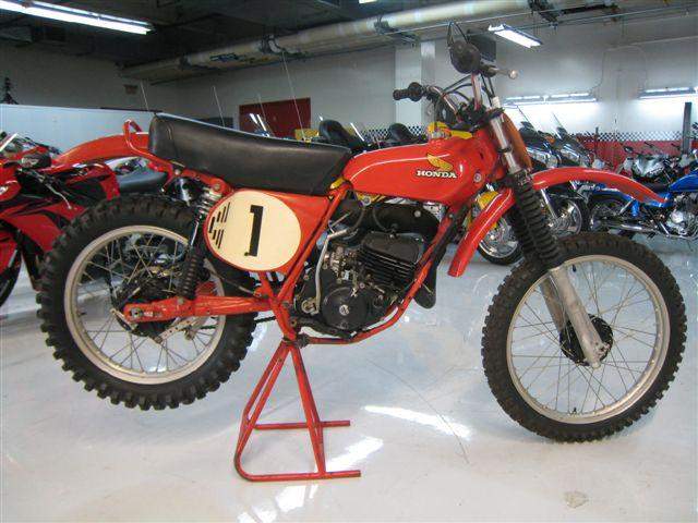

I saw something similar on Marty Smiths bike at Mid Ohio in 75

PostPosted: Sun Apr 07, 2013 4:00 am
I did nearly the same thing (very similar to your 2nd photo) and it seemed like the rear wheel hopped less under braking than with the stock setup. If I go with a custom arm I'll definitely be using the shorter brake stay.

PostPosted: Sun Apr 07, 2013 6:49 am
to do that I will need to remove the already painted swingarm
I just drilled a hole in the swingarm gusset, slightly below the bottom front of the shock mount. I shortened a spare brake stay, flattened & drilled one end, bent it to fit, and that was that; used it for years with no problems at all.
