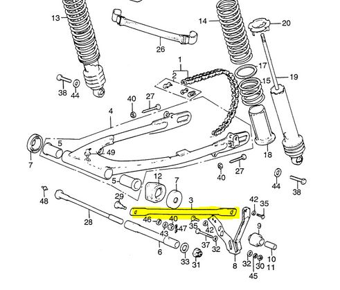

There's a missing rear brake stopper arm on the 1974 CR125M that I work right now. Can someone tell me the lenght of this arm between the center of the 2 holes?
(part #3 in yellow on the picture)
Thanks!

14.25" between bolt centers.

Thanks, I'll made one of the right size!
